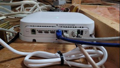

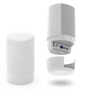

    I currently have the left - Network Access Hub(with coax) and Right - Boost Wifi 6 AP - These were installed by Telus tech and work great together.   I have the old T3200M and a gigabit switch to work with if needed.

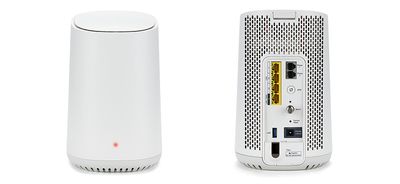

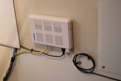

      Which square fibre box do you have? There are two different ones. Do you see a brand or model on it? Does it have a coax port on it also? There are also two white cylinder shaped devices Telus offers as well. There's the Wifi Hub and the Boost 6 wifi access point (not a router).
      Left is the Network Access Hub. Right is an ONT (no coax port).
      Left is the Wifi Hub. Right is the Boost Wifi 6 AP.
