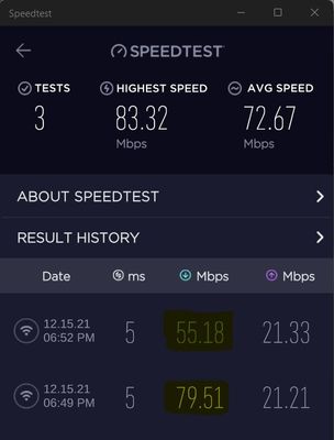

        My speed test at the router. I usually get from 79 - 85 Mbps. I'm on Internet 75. 😁
        My speed test from my PC. The first test 79.51 Mbps was with 5GHz WiFi connected with a link speed of >485 Mbps. It matches the test done on the router. The second test 55.18 Mbps was with 2.4GHz WiFi connect with a link speed of 150 Mbps. It is slower than the test done on the router even though the link speed is 150 Mbps. I have a lot of smart devices connected on 2.4 GHz so the throughput is less than what the link speed indicates.
