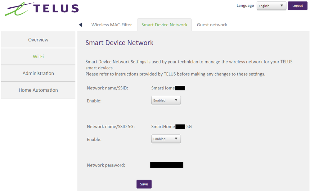

  • The Wifi6 Boost unit has a separate 2.4GHz wireless network that can be used. Additionally it has a dedicated smart devices option that you can use. You just need to enable it. The only drawback for that Smart Devices Network is that it has a fixed password.
    If you wanted to put all smart devices onto a single separate SSID, do the following to enable the Smart Device network:

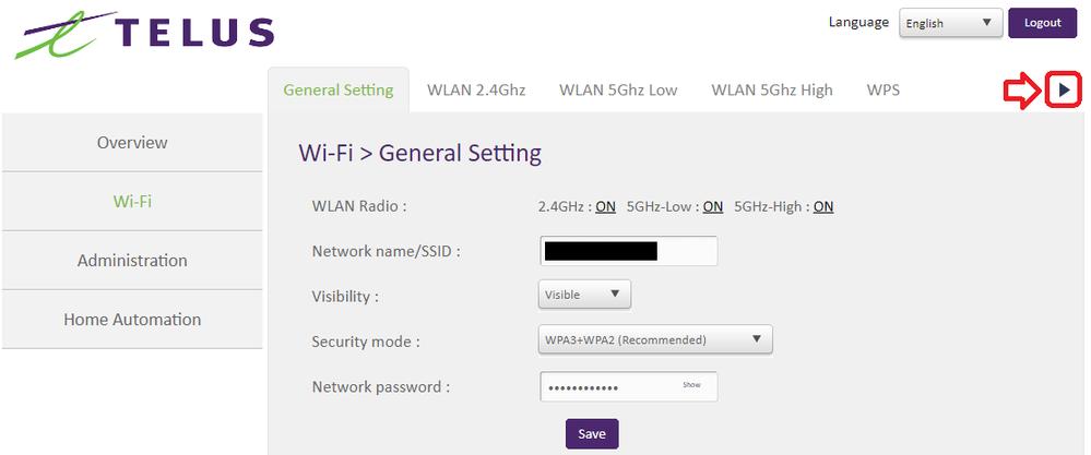

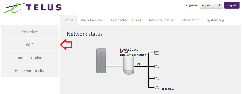

    1. Once logged in, click on Wi-Fi on the left menu.
    2. Click on the little black right arrow in the top right of the page:
    3. Click on Smart Device Network
    4. For each network, change the drop down menus from Disabled to Enabled You'll see the password below both networks:

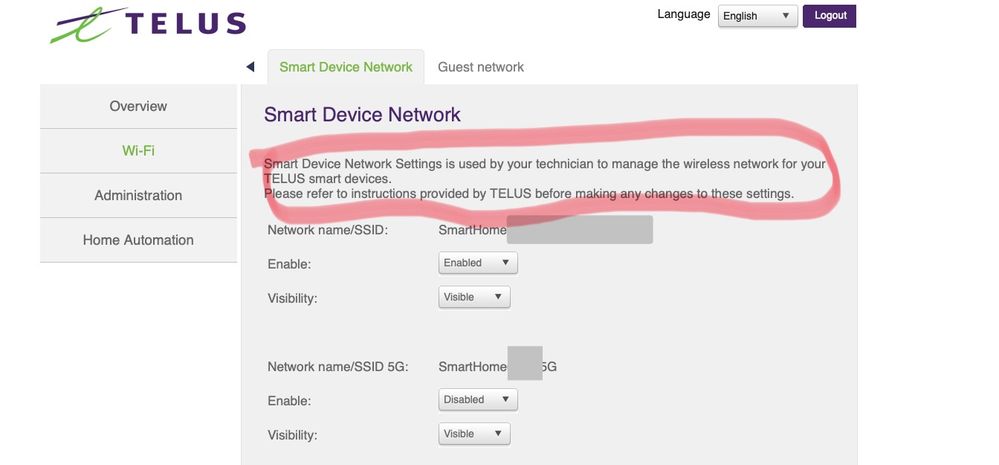

  • I just changed my setting.
    Note the comments in the red circle. Is this for only Telus products??
    And no option for security mode...or do I update this some where else to show here?
