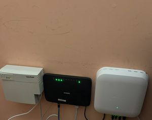

Hi all how to do bridge mode.
Hi folks I’m planning to buy my own wifi router a WIFI 7 router so my two questions are. number 1 do I need to find a pfsense router? Or can I use any wifi router? Also after I bridge m...

Awesome posum brother 👊. So if I get my own router and connect into the modem will I need to bridge mode the nah first? Or will it work smoothly planning to get a tp link router.
Will the black ont continue to work perfectly since it’s for the home phone. Thanks.

you would first connect your personal router to the port 1 lan port or the 10 Gb lan port on the telus network access hub modem.
last step is to configure the bridge mode setting either port 1 lan port or the Port 10 G bridge mode setting.

Or is 10gbps already running into both the nah and Nokia ont.
- Adila211 months agoOrganizer
Gotcha is it possible to do it the other way around connect a cat 8 cable into the black ont port from the port connect into the 10gbps unmanaged switch. Then connect one of the 10gbps port into the nah then turn on bridge mode of one port 10gbps. Because back of the wifi router there’s a 10gbps wan port. Thanks! Or should I call Telus to freeze the 10gbps on the nah and activate its home phone port?
