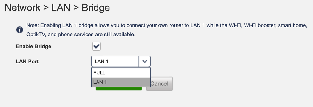

Okayeeee.... alrighty... I just got off the phone with Telus Residential Customer Service...
"Chris from Calgary" gave me help I desperately needed.
As it turns out, I've been overlooking a setting...
When you get to the advanced settings of your Arcadyan Hub...
I didn't notice the LAN Port option actually has a drop down (!)
So now I can run own router and still make use of the 3 new Boosters I just bought!!!!
Huge props out to "Chris from Calgary"! I've been toiling on this issue for a while, made my life 100% better 🤗

- xrayHero
I suspect there is no routing between LAN1 and the other devices on the Arcadyan. This will only be an issue if you need to communicate between the 2 LANs. For instance if you have a network printer, smart device or NAS on one LAN you will not be able to see it from the other LAN.
- NFtoBC
Community Power User
Thanks for sharing. I missed that drop down a few weeks ago when a previous question was asked, even though I had previously set up LAN1 bridge. I thought it had disappeared in an update.
