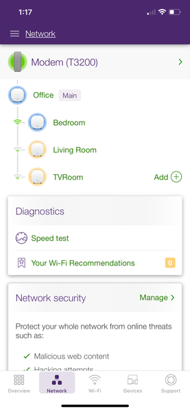

WiFi Booster Coverage?
I'm wondering if someone can explain how the Wifi Boosters work in conjunction with the T3200. I have added 4 boosters and 2 of them say i should move them closer to the router. That seems counterpro...

3 years agoA mesh system slows as the number of hops increases, and the distance between them increases. As the signal slows, the mesh system suggests moving the devices closer together.
Have you the opportunity to run ethernet to any of the Boosters? It will allow them to run faster.
