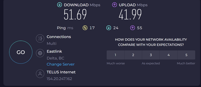

Wi-Fi + service and so called dead zones.
I've been with Telus for 7 years. Recently, my internet connection became real slow (50-60 mbps) and I'm paying for 150. So I called Telus and after 2.5 hours I was told to buy a Wi Fi + service beca...

BeoVB What kind of speeds are you getting when you hardwire directly to your router? Do you have a computer/laptop that you can plug in a test? Would help us help you if you can take a screenshot of those results. It'll help determine if this is a backhaul or wireless issue.
- BeoVB2 years agoNeighbour
I use only WiFi. The speed is between 50 and 60, usually low 50s.
I had 2+ hours of discussions with your colleagues on Thursday, they ran different tests, made me download one of telus's apps, and connected to this app. In the end, they told me "We don't see problems on our end, buy WiFi+"- TELUS_Support2 years ago
