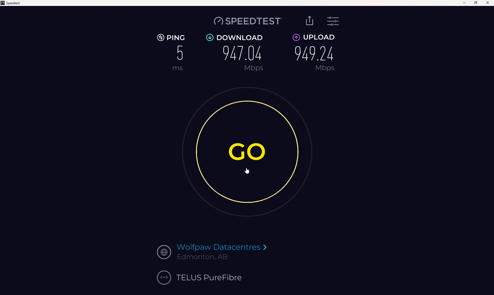

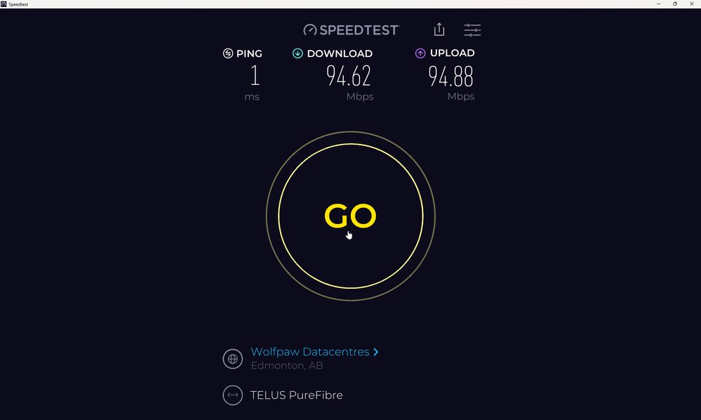

2 years agoFriendly Neighbour
Update ONT to Switch and then to two different routers the telus one and my cisco one.
Had to make sure I tested it out before I ask from nighthawk
Results the telus router gives out 940mbps consistently (mind you it's connected via the coxial cable for the telus WAP (3 of them) throughout the house and hard wired from one of the WAP to two computers in my office.
My Cisco router however is only giving out 90-93 Mbps. It's hardwired to my kid computer. New computer gaming .
Not sure why this is happening . Tried to call telus support and explained but they don't recommend using a switch.
Does telus provide 2 public address on residential home purefibre internet service?
Any suggestions to the speed difference?

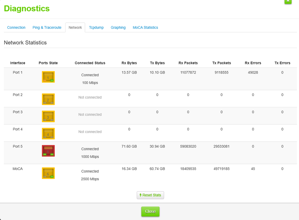

- DT19682 years agoFriendly NeighbourSorry for the late reply, NighthawkHere's my findings after a few tests of my own. Definitely when I use my Moca connection plugged with the Telus WAP the speed is incredible. (plugged into the WAP port) Mind you took a few changes because I wanted to see if it's my equipment or something else. Rewired brand new cat 6 cables, running the tests with both my mac mini m4 computer, new 2.5 switch (borrowed from a friend) . When I'm plugged into port one of the NAH20T only outputting 100mbps and when I.m hardwire from the moca WAP it's giving me speed above 900mbpsI can see from the telus web login port 5 is my 10gb port and giving out 1000mbps from the ont and moca at 2500mbps . But for now, I'm at my Witts end and will use the WAP hardwired for now to the kids' room and use the switch to distribute the speed to my computers and the kids' roomDT 1968
