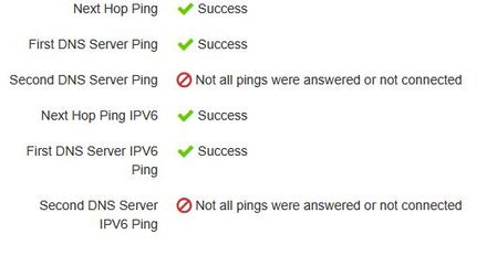

Hello, the secondary DNS servers pushed to the router by DHCP are not working, both for IPv4 and IPv6. This has been ongoing for a while.
The above is captured from the router.

Ah, using nslookup works on the secondary DNS server (and also Resolve-DnsName for the secondary IPv6 server).
However, it is greatly misleading that the router (diagnostic) shows that the secondary server is not responding (as shown in the image in the first message).
I think Telus needs to enable ping on those secondary DNS servers.

It may well be the case that DNS servers are blocked from replying to ping, but the test shown by the OP is being done by the Telus-supplied router. If the secondary DNS servers are being blocked from replying to ping, why are they being tested by the Telus-supplied router using ping?
