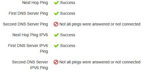

Secondary DNS Server not working
Hello, the secondary DNS servers pushed to the router by DHCP are not working, both for IPv4 and IPv6. This has been ongoing for a while.
The above is captured from the router.

Telus should not push DNS servers that are not working.

  • It may well be the case that DNS servers are blocked from replying to ping, but the test shown by the OP is being done by the Telus-supplied router. If the secondary DNS servers are being blocked from replying to ping, why are they being tested by the Telus-supplied router using ping?

    However, it is greatly misleading that the router (diagnostic) shows that the secondary server is not responding (as shown in the image in the first message).
    I think Telus needs to enable ping on those secondary DNS servers.
