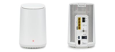

        Normally you won't have both of those devices. Are you sure the white cylinder isn't a Wifi 6 Boost AP? How many ports are on the back of it? The NAH doesn't have wifi on board so a Boost AP is usually provided with it. It isn't a router and you do not want to have it connected to a bridged NAH.
        Boost:
        Telus Wifi Hub:
