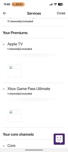

Issues Activating Premium Channels on Optik TV
I am running into continuous issues when trying to activate my premium channels on Optik TV. I recently signed up for the service and received the emails to activate, but when I click Activate Now it...
