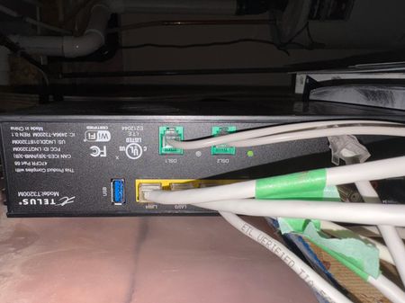

Internet 75 - slow speed, T3200M only one DSL port working?
I have Internet 75 with Telus and it is the fastest I can get as fibre is not in my area yet. The speed has always been a bit off and after running speed tests I'm getting 35 download and 10 upload c...

1 year agoI have Telus Internet 100 on dual copper with the T3200M. I checked the rear of the T3200M and I both the indicators for DSL1 and DLS2 are illuminated. I believe this plan is supposed to be 100 up and 25 down with a total of 1000GB of data a month. I regularly see 115 and 30 with a wired connection.
Doing a speed test from the T3200M results in 115 and 30 consistently.
When I check the Status>Line 1 and Line 2 when logged into the T3200M both show as connected and interleaved.
Are you performing the speedtests directly from the modem? If you are on wifi the numbers can be significantly lower.
