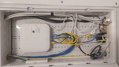

The house has the Telus NAH that connects with our pre-wired ethernet and the NAH was already setup by the previous owner who was also subscribed to Telus (Figure 1).

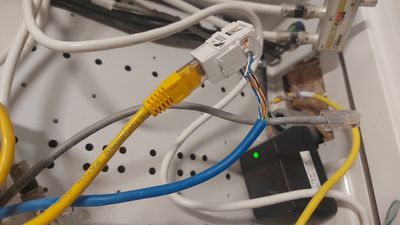

When our Telus technician arrived, he had to rewire? or joined, one of the pre-existing ethernet cable (blue) of the house with his own ethernet cable (yellow), to connect to the NAH (Figure 2). He said that these blue cables aren't real ethernet cables, because they must click when it goes into the NAH port. It's true some of them do not click, but some do. But I'm pretty sure on all the blue cables, including the one he rewired, says CAT5e.

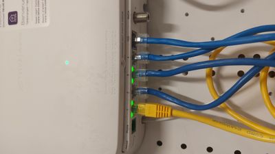

Now only the NAH ports that is connected with the yellow cable is lighting up (Figure 3); when moving the yellow cable to the other ports, the other ports light up. In contrast, all the blue ethernet cables does not light up regardless which port its connected on (I tested all 5).

Figure 1 (Internet Box)
Figure 1, Internet box, with Telus NAH connected to ethernet cables. As well as Coax cables on splitters. There's also a model to connect a yellow wire running into the walls with the rest of the ethernet cable.Figure 2Figure 2, Yellow ethernet cable connected to TELUS NAH port 1 from technician conjoined with an adapter to a rewired house ethernet cable. (Yellow ethernet cable joined with blue)
Figure 3 (Telus NAH ports)
Figure 3,TELUS NAH ethernet ports with only Yellow ethernet cable on port 1 lighting up, and the other 4 connected blue ethernet cable not lighting up.Figure 4 (One of the ethernet outlets on the walls)

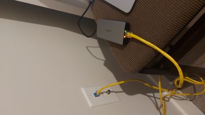

For NAH ports lighting up, it should light up when connected to a laptop. So when I said I tested all 5, I connected my laptop with an ethernet cable to one of the not working blue jacks on the wall, and then I shifted the blue cables with the NAH around to see if either the NAH or my laptop port would light up. Neither did for all 5 blue cables.
But when I connected my laptop to a working blue jack, one of the ports with the blue cable at the NAH did light up. Does mean that lit blue cable is wired correctly on both its end and the non-working outlet has mismatched wiring pattern? Or is there a possibility the non-working outlet itself is broken?
Working outlet connected to my laptop
Port 3 lit up a working outlet connected to my laptop and had internet.
Working cable on the left and an unlit cable on the right (looks the same to me).
