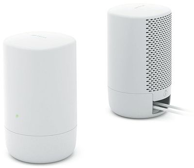

You likely can't find it because the NH20A is a wired router only. One of the additional wireless access points is where you'll find the wifi settings. Normally the Boost 2.0 unit (white cyliner) is paired with the NH20A. Do any of the devices in your house look like this:

Neighbour
4 Messages
How do I log in to them ?
Neighbour
4 Messages
All fixed now thanks to you.
Got in to the right access point, turned off 5ghz, reset all ecobees, added them back on 2.4ghz and then turned 5g back on .... DONE.
