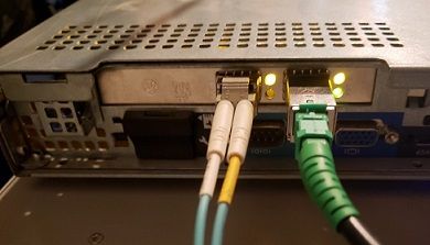

With the right gear you can hook the SFP ONT directly to a third party router. PersonalIy I perfer to bypass as much consumer grade equipment as possible.
Below the SFP is hooked directly into a 1U enterprise server E3-1270 V3 with 16G RAM running open source PFsense, more enough to let you run full AES 256 VPN encryption on even the 1.5 Gigabit packages, full duplexed at line speed. Telus will not support this for multiple reasons.

In this case a SFP ONT with compatible L3 switch works perfectly. Had this setup before with Actel networks L3 switch with 4 fibre ports and Telus SFP hooked right into it. To my surprise this configuration would assign an external Telus IP address to every device connected to the switch. From there simply hooked up the T3200M and the switch with a couple of Intel SFP's and she worked perfectly with the Telus Optic TV running on its own separate network. A second fibre link went from the switch to Pfsense router for main networking with hardware VPN encryption running on a completely separate external IP address than the Optic TV.
As i have alluded to in a few posts now there are many things getting rid of the wall hanger lasagna boxes in favor of a direct hookup with an SFP ONT's will allow people to do if they have a little bit of technical aptitude and do some research.
