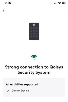

    This error message just started today for me. The pannel shows that it is connected to my home WiFi and nothing changes when I try and re-connect to WiFi. I ran a test of my router and it checks out. Also ran a WiFi connection test of the Qolsys panel and it came back okay. I will call tech support later this week. Please share if a solution is found.
