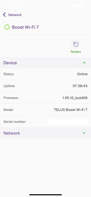

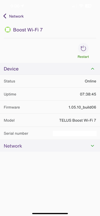

  • Ah okay, so it was most likely trying to update the firmware.
    I believe you meant the "telus connect" app as the "my telus" app, I'm not seeing a network tab. Firmware version I'm not seeing "pending update". This screenshot is from this morning (9:06AM PST) and you can see the uptime is 7hr 38min which means it restarted again around 1:30AM. This screenshot was also before I did the hard power cycle but the firmware version stayed the same when I checked after: "1.05.10_build06"
    • TELUS_Support's avatar
      TELUS_Support
      That looks correct, yes. With no pending update you can rule that possible reason out.
