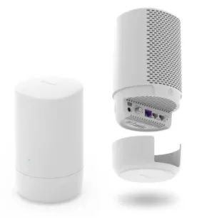

    I'm assuming your wifi 6 equipment is the newer Boost 2.0 access point. You shouldn't have any issues using the 2.4GHz smart bulbs with that. Have you logged in to the Boost unit and checked the settings? It's a separate IP and login than the main router. There are settings for the 2.4 and 5GHz networks as well as settings specifically for a 2.4GHz smart device network that is disabled by default, but can be enabled easily in settings.
    The Boost 2.0 device looks like this:
