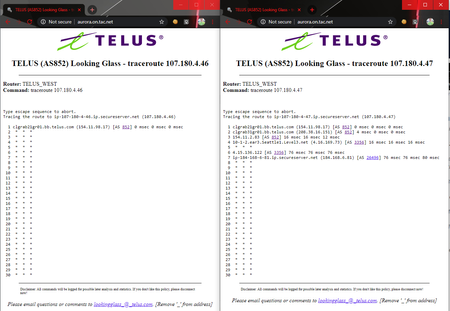

Hi, I'm unable to access a singular IPv4 address, what's the best way to get support for this? The issue appears to be with the Telus WAN routing for this singular IP address (107.180.4.46). I've con...

Oh, another GoDaddy shared hosting server. This isn't the first time there has been an issue with a GoDaddy shared hosting server and Telus users being blocked from accessing it. The previous GoDaddy IPs reported also started with 107.180.x.x. I also don't seem to be able to access any domains hosted on that server.
Since images aren't loading, I assume your traceroute looks something like this:
traceroute to 107.180.4.46 (107.180.4.46), 64 hops max, 52 byte packets 1 192.168.1.254 (192.168.1.254) 1.270 ms 0.793 ms 1.012 ms 2 * * * 3 * * *
I don't know of a fast fix for it aside from a VPN temporarily. I'll ask if someone can look further into this.

5 years agoOh, another GoDaddy shared hosting server. This isn't the first time there has been an issue with a GoDaddy shared hosting server and Telus users being blocked from accessing it. The previous GoDaddy IPs reported also started with 107.180.x.x. I also don't seem to be able to access any domains hosted on that server.

Thank you for the quick response Nighthawk! I was able to find the thread you were talking about and I agree it seems to be the same issue.
Hopefully this image works, it is a screenshot from the Telus BGP looking glass website.
https://i.imgur.com/NjdQb05.png
hxxps://i[.]imgur[.]com/NjdQb05[.]png
Hopefully it can get to the right person that's able to fix it.
