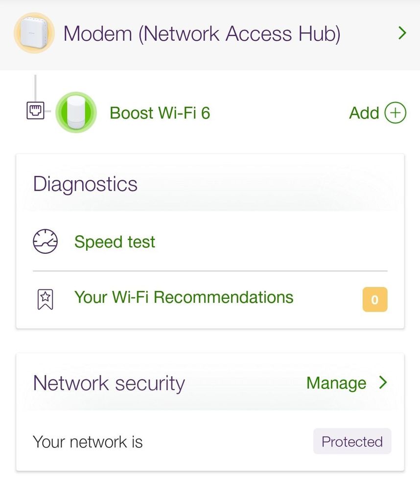

  • So the Telus technician I've been dealing with -- but doesn't know how to move forwards since he doesn't have the equipment himself (although his manager is threatening to change this, but who knows how long that will take) to test above 1000 Mbps and the mother ship says everything is configured properly -- suggested trying the speed test feature built into the Telus Connect App:
    I hadn't seen this before so I thought I'd give it a try. Not sure what it does, but hoping it reports on the speed between the modem and the internet via fiber, and not between my Samsung phone and the booster via wifi. Anyway, when I click on that option -- and I've clicked half a dozen times -- then the app always crashes and I have to restart it 😞 Once the phone popped up this short message:
    That's the only buggy feature I've seen in the Telus Connect App [1] because I've been using it to track new wifi devices connecting. Does this feature work or crash for others?
    [1] Except when I was first upgraded to fiber. The app didn't recognize the new system. Had to call Telus support. They told me to uninstall and re-install the Telus Connect App and then everything started working with the new system.

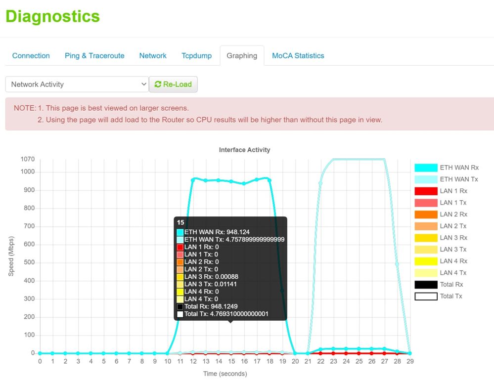

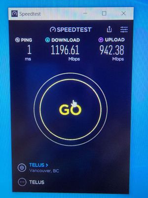

    I did another speed test late yesterday evening, with the same laptop and everything, got significantly better results:
    So why do I suddenly get +150 Mbps? Wouldn't this indicate some type of issue on the side of Telus since my equipment has not changed since the previous tests?
    Other thoughts: The diagnostic graph from the Telus FXA5000 modem looks suspicious, or? Why? The 1050 Mbps run is obviously artificially cut off at the top of the graph and becomes a straight line. Whereas looking at the upload graph then instead of being a straight line, it's kind of wavy but flat-ish. During the test then the speed test download Mbps does slowly climb and isn't flat. So I'm wondering if the FXA5000 is configured wrong? Why would it be showing the graph only up to 1070 Mbps on the y axis if the modem is capable of a lot more? This seems like the biggest indicator that the Telus equipment is incorrectly provisioned, or? What do you guys think?

      SimonHF Wrote: So why do I suddenly get +150 Mbps?
      The pictures finally started to show, so I was able to see them. I'm guessing that your connection is working about as well as you may expect now... You will probably see the DL speed increase at different time of the day given network traffic etc... looks like you got the full upload speeds as promised by Telus.
      Give it a few days to settle in, and see the results then... Cheers...

      SimonHF Wrote: This seems like the biggest indicator that the Telus equipment is incorrectly provisioned.
      If I was a betting man, my guess would be on the Telus side. Reasoning, all you connections are indeed at 2.5Gbps, so a 1.5Gbps connection should be fully capable here. Reading the other thread, it seems to mimic your issue. I know that Josh ( The fellow you contacted) as a Telus employee have some capability that we don't when it comes to solving backend issues. (However, Josh reminds us that ...This isn't an official post from TELUS, and I'm not paid to do this.)
      Hope you get this solved... Cheers...

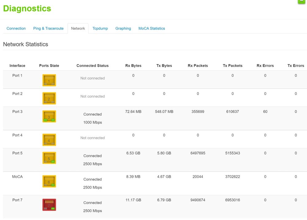

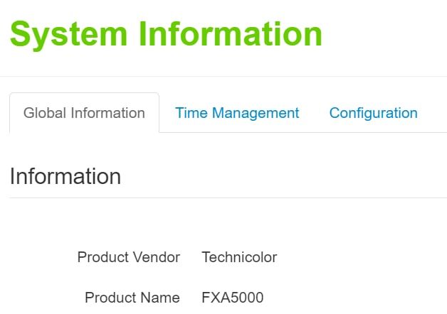

  • Here are some screen shots from the Telus modem showing the model, the 2.5 Gbps network connection, and the modem's own graph during the speedtest:
