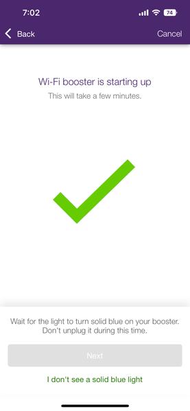

the tech said that the technology is backwards compatible so it should be fine. but the app is stuck. it gives me the green check mark, the light is solid blue but i cannot move forward with the app as the next button is greyed out,

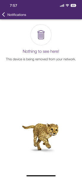

as you can see its just nothing, i don't know whats going on. i tried both of them same thing. i get a notification saying a booster has connected to my home network and then i look at that notification and it says this
which makes no sense to me at all. i need Ethernet in my room my PC doesn't have an available pcie slot for my old network card. i seen a similar thread where user: NFtoBC​  said go to the admin page and i was hoping he would be around to help me with this one.
