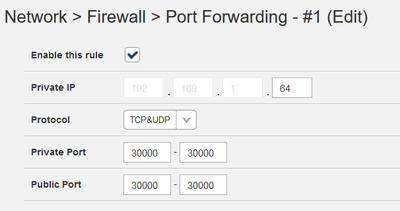

      I've removed the DMZ, and went back to the standard port forwarding application. I've rebooted the modem after all of these were applied and refreshed the application. But it still looks like the connection is closed.
      Current setup is (with screenshots):
      • Port forwarding enabled on my public IP on port 30 000 to point at my server

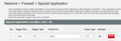

      • Special application of port 30 000 to prevent the NAT from interfering

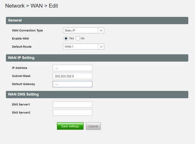

      If my research is correct, my IP address is being changed frequently due to WAN, and I should request a static IP. However I'm poorly versed in how to request a static IP in the following fields and how I should request the modem to set this up

        While I can't see the screenshots yet (pics are moderated) I can confirm that you should not need a WAN static IP. My WAN IP hasn't changed in a very long time. I'd guess at least 6 months or more. Static IPs are usually only available on business connections if I remember correctly. Setting your PC on a static IP within the LAN is probably a good idea.
