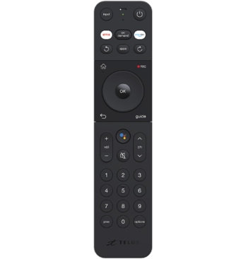

  • Is this for the newest box (21T)?
    If so, hit the voice button on the remote and say “maximum set top box volume”.
    Hope that helps.

      This was the simple answer for me. Double tap the "Google Assistant button" above the mute button, then say "Maximum Set Top Box volume".
      Device: TELUSTV-21T
      Remote: TELUS TV Remote (Not Slimline)
