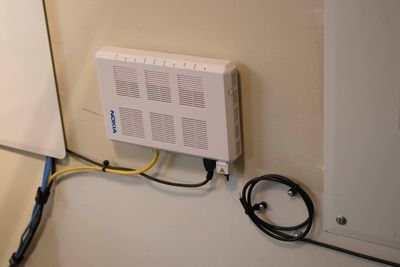

    The "fibre to copper converter" you are talking about is the ONT. Fibre goes in. Standard Ethernet and phone comes out. If you have a landline still, you'd end up with an ONT. It has a pair of RJ11 phone jacks on the back and if you have more than one phone in the house, the installer could hook the ONT to one of your existing jacks as well. If you don't have a landline they may just install a router instead that the fibre connects to.
    One type of ONT Telus uses:
    Telus will not run electrical. That is the unit owners responsibility. If the builder didn't put power or ethernet where your panel is, the ONT won't be installed there.
    You mention the power use of the fibre hardware. There is one single piece of hardware and that's the ONT. The ONT I have uses very little power. The cost per year for the power has been very minimal and I haven't even noticed a change on my bill. Your router will use a fair bit more power than the ONT.
