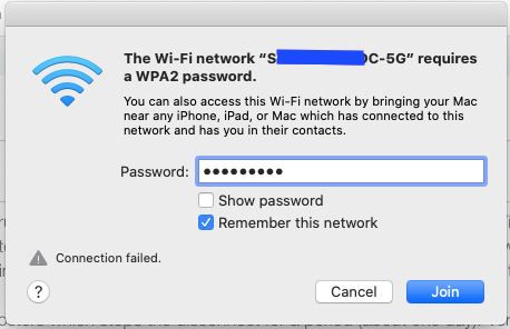

I'm having this same issue with a Macbook running macOS Catalina (had same issue with macOS Mojave) . WiFi disconnects (sometimes every 10 seconds // sometimes every couple of minutes). Often times, when auto reconnecting it will bring up a "connection failed" Mac WiFi dialog box asking for password even though the password is saved and is correct (screenshot below). I have to select the WiFi network and "Join" again.
The solution is usually to restart the WiFi Boosters OR restart my Telus T3200 router which stops the issue of disconnecting for a period (about one day). Very annoying fix. The reason I believe restarting the Telus router fixes the issue is because it causes the WiFi Boosters to loose their Ethernet connectivity and it renews it's configuration once the Telus router is back on-line again.
