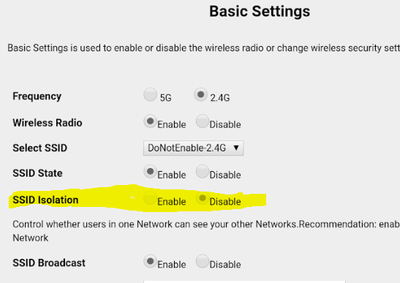

T3200M SSID isolation - can't change setting
I have been tearing my hair out over this... does anyone have any suggestions? T3200M has port 1 bridging to my own router (connected to VPN), so have to use Actiontec gateway to access my home s...

What firmware version is on the T3200M? I'm on 31.164L.18
- xray7 years agoHero
My setting is on disable and I cannot change it.
- mtn7 years agoAdvisor
Well, at least I now know that is the default setting. Seems backward to me. This also can affect printer discovery, unless there is another setting somewhere else that allows a wifi connected laptop to see other computers and printers.
When SSID Isolation is set to disable that means devices can see each other on the network. That is what you want.
