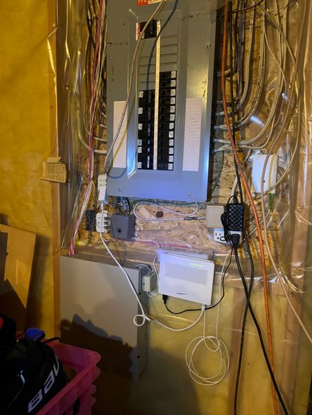

T3200M not wired for Gigabit from ONT
Hi all, Yesterday I upgraded my Internet from Telus 75 to PureFibre Gigabit. I was noticing that I was only getting/maxing out at 100mbps through the T3200M (ethernet and wireless). That's when ...

It is connected to the ethernet WAN port on the T3200.
The T3200 is located upstairs and a little bit away from the ONT, so it is not directly underneath the ONT.
So it goes. ONT out on LAN1 via ethernet to the ethernet to DSL switch then upstairs theres a ethernet wall outlet that is connected to the T3200.
I assume it is this adapter that is making my T3200 not give Gigabit speeds.

2 years agoHow recently was the fibre installed? If fairly recently and if you have the installers card, maybe reach out to them. If not, I'd recommend reaching out to support to get a tech out to ensure you're able to get gigabit to the T3200. I've never seen them use that type of adapter before. The big issue will be if the line leaving the adapter and going upstairs only has 2 pairs of wires in it like a regular phone cord. If it does then it's physically incapable of delivering gigabit speed. Gigabit needs all 4 wire pairs on the ethernet cable.

I'm pretty sure my home phone line will be okay right? I just need to get rid of that adapter and run a straight ethernet to ethernet connection from the T3200M and ONT.
Would Telus be able to fish this ethernet to ethernet port for me?- Anonymous2 years agoNot applicable
