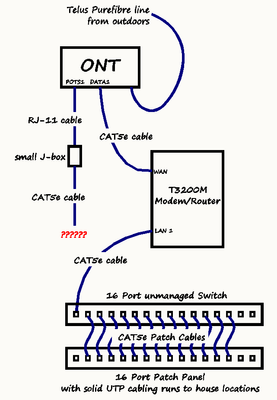

I’m doing a full basement reno in our 70 year old house, so all the walls and ceilings are open for excellent access for wiring. We plan to install ethernet cabling and phone lines to several locations in the basement and on the main floor. Our current Telus account includes Purefibre internet and Home Phone. So I’m drawing up a plan to install a modest structured cabling system, including rack mounted power strip, unmanaged switch, and patch panel. I’m pretty clear on how to deal with the internet end of things, but I’m asking for guidance on how to work the Home Phone into this scheme. Can the phone lines be switched? Or can a hub work? Or should they just be hard wired as a daisy chain? Or what?
I wanted to attached a block diagram of my plan to this point, but there seems to be a problem with photo uploads, currently. The internet side of things looks like:
Purefibre -> ONT, ONT Data 1 -> T3200M Wan, T3200M Lan 1 -> Switch -> Patch Panel -> house locations.
The phone setup is:
ONT POTS1 -> J-box -> current RJ-11 jack
As you can tell, I am not a telecom pro. Any suggestions for a workable approach for the phone would be very welcome. Thanks very much for any input.

    Phone lines as simple daisy chain is fine.

      So treating the phone end of this setup just like the old copper based systems would work fine. Is this the most elegant way to go about this? Are there other possibilities? I'm really just curious and want to know more about this type of phone through fibre.
      Thanks again for your input. I appreciate it very much.
      • NFtoBC's avatar
        NFtoBC
        The telephone output of the ONT was simply connected to the existing copper phone wires (4 conductor) in my house. The Tech simply disconnected the incoming copper phone line at the demarcation point, and connected the ONT output instead. It took longer to reprogram the line from copper to Fibre than to make the connection.

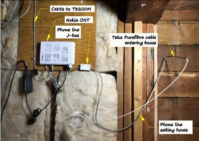

      We are in the city now, and are on the Telus 300/300 plan with home phone. The phone definitely comes through the fibre line. Please have a look at the two images below. One is a photo of our current temporary installation, and the other show the scheme I’m considering (with the phone question mark).
      The phone cable comes from the POTS1 port on the ONT, changes from RJ-11 cable to cat5 in a white small j-box, and then exits the house through the same hole the fibre entered. It then climbs up the exterior wall and into house on the main floor to supply a single RJ-11 jack.
      Hopefully, that fills in the picture a bit more clearly. Thanks again for your thoughts. 
