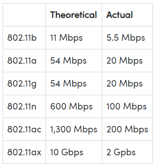

      I think the basic problem is that you have a high potential speed with PureFibre, but the signal is still sent through the fairly standard T3200 modem/router. The T3200M Manual suggests this is an 11ac wireless modem, but the specifications show a maximum of 11n. See page 64 in the manual. According to the table that NFtoBC posted earlier, and shown below this is the limiting factor for wireless. It would seem that if one wanted faster wireless you would have to buy your own third party modem/router to get for example 802.11ax and a much higher wireless speed. With the standard T3200M modem the manual suggests a maximum of 300 Mbps, but this table indicates 100 Mbps.
  • The latest iPad Pro looks like it has this for WiFi:
    802.11ax Wi-Fi 6; simultaneous dual band (2.4GHz and 5GHz)
    This should give you up to 2G according to the link posted by NFtoBC . It would seem that the limitation must be in the booster or router. You may want to look at the WiFi specifications for it.
  • NFtoBC's avatar
    NFtoBC
    Possibly in the 400 Mpbs range, but likely slower. Wi-Fi is not going to be as fast as an Ethernet connection. See this link for more info.
