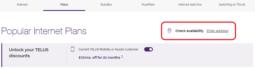

  • Nighthawk's avatar
    Nighthawk
    Telus won't run internet through coax outside of a residence. I'm not sure if you're parked on a private lot or in an RV park/resort but you need to determine if Telus even offers service to your location. If you go to Telus's website, look for the Check Availability - Enter Address link. Once you enter your address, it will tell you which services are available in your location.
