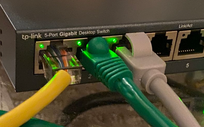

        I worry this might be beyond my ability to comprehend the answer but here goes. Given the internet is coming in on CAT cable, can I plug that directly into a switch, say port 1 of switch, and then attach my Telus NAH (to port 2 of that switch) and the suite CAT cable (to port 3 of that switch)? I would then attach the wireless router to the wall in the suite, which would then get the signal from port 3 of the switch, which in turn gets internet from port 1 of the switch. I hope that makes sense...
        If this is viable, what switch should I use? I have used one type before (see the photo below for an example of a switch I already have in the house to run multiple devises in a room). Maybe I should get a fancier switch or it that OK?

        Switch I have in the house already for another purpose:
