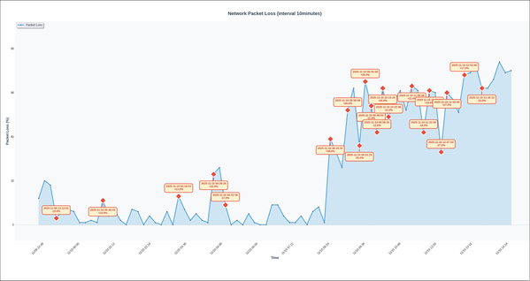

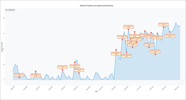

      My network is completely idle, with only the computer used to test packet loss connected. I've been testing for about 12 hours and I've created a chart with the results. Packet loss has skyrocketed and is as high as 80% at the time of writing.
