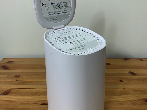

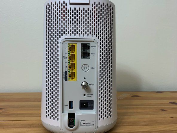

      You currently have the Telus provided router that looks like the following

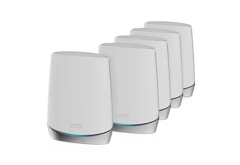

      And you want to add the Orbi Tri-Band WiFi 6 Mesh?
      Ok, this is possible indeed.
      You’ll have to log into your Telus router that you currently have. Find the setting to put that device into what is referred to as “Bridged mode” That will effectively render the Telus modem nonfunctional. It will only be utilized to passthrough the internet signal to the Orbi Router.

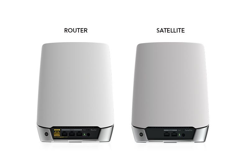

      Connecting the Orbi router will take over the function of the Telus router from there on out. So, that is where you'll have to do all of your network configuration from that point forward.
      Depending on your needs you will be able to expand the number of satellite’s connected to the Orbi system that will meet your needs, I believe it is expandable from 1 satellites, to a total of 4.
