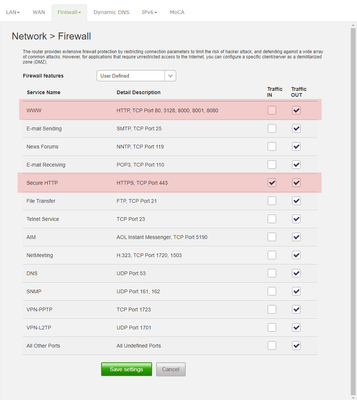

I believe that the irrigation controller uses port 8080. I see under my default firewall settings that this port does not allow traffic in, but I seem to have the ability to select to allow traffic into some, or all of these ports. I thought maybe allowing traffic in via port 443 and using that as my forwarding port would be a good, secure option? Maybe more so than just allowing traffic in through all of the ports listed in that first line with port 8080 or all other not listed ports (last option)? Either way, I still can't get it to work... I've pasted an image below, hopefully it will display correctly in this post.

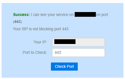

I have checked ports 443, 80 and 8080 on CanYouSeeMe.org and all appear to be visible. I'm not sure if that is to be expected or not based on the firewall settings to allow traffic out from these ports, but not in? I would have thought no...?

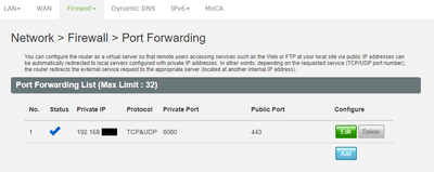

I've tried multiple Private and Public port combinations under the port forwarding section with no luck, although I'm still not 100% sure I understand how to configure this page correctly. ie. should the Private port be 8080 or 443?

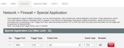

I've also tried setting up the Special Application section using 8080 as the Trigger Port and 443 as the Public Port, again not sure if this is backward or even if this is an applicable solution for the problem I'm trying to solve...?
