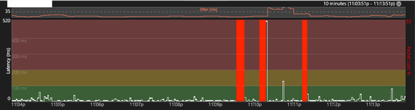

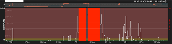

I have Telus fiber and it has been pretty much fine for ~1 year, but getting connection issues today. Figured I would ask the community before reaching out to CS, have seen lots of helpful posts.
I have the white square Network Access Hub (NH20A) as well as the small Boost 2 router(?), and have been getting huge latency spikes and packet loss basically leading to a complete disconnect for ~1 minute. My wifi connection to the router remains at full strength. An example of this happening below, with charts showing constantly pinging the Network Access Hub and the Boost 2:
Access Hub: latency up to 2650ms with 100% packet loss for 1-2 minutes
Router: latency up to 520ms with 100% packet loss
I've tried restarting both -- any other ideas before I reach out to CS?
