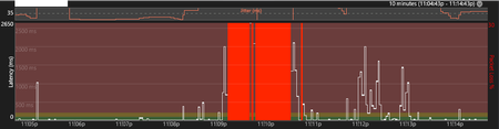

Hi all I have Telus fiber and it has been pretty much fine for ~1 year, but getting connection issues today. Figured I would ask the community before reaching out to CS, have seen lots of helpful po...
