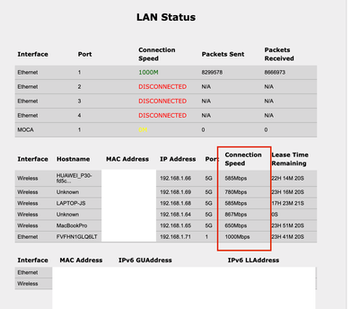

    Also I found stats in the router and they don't really match with what I see  from a browser test (wifi) .
    These results are higher :
    I guess without AX wifi router or booster,  then no real gain going with 1G , 500mbps would give me ma max speed anyways . Right ?

      The built in tests haven't worked in years. They're good for 250mbps connections but not faster. It's been mentioned on the forums here in the past but it's been quite a while since I've seen it. You'd need an actual external speed test site like speedtest.net or fast.com.
