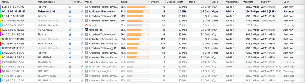

  • If you have Gigabit Ethernet on your computer, then the theoretical max is 1000 mpbs. For WiFi, the max for 5G is 1733 mbps, so you will probably get higher speeds on WiFi in that range. The max for 2.4G is lower at 385.2 mbps for a Telus Boost. Here is what I see with WiFi Explorer. The 5G and 2.4G networks are on a T3200M and the Ridernet network is on Telus Boost which are hardwired to the T3200M.
    Here is what I see in WiFi Explorer on my MacBook.
