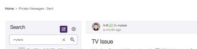

Actually I sent you a private message on that day (it's still in my Sent folder)
I'll send another now, thanks.
