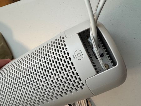

How to setup Fiber 5gbps to multiple devices
Hi there, A Telus tech today came and installed fiber access into my downstairs office. I have two computers that can utilize up to 10gbps connections in this room (PC + Home Server). The provi...

In terms of switches, would something like this work?
In the modem/router settings, would I keep it as routed or would it be under Port 10G bridge?

The device you posted from amazon seems to be an intelligent switch and that is ideal; no need for network noise.
as bridge vs routing goes, that is totally biased on your desired topology; I am not sure on the technical capabilities of posted switch, but I would bridge the 10g port to the port of the switch that has the ONT connection and use the reminder on the YuanLey device to act as a switch. If I understood what you want to achieve. If isolating ports is not possible on that switch maybe routed is what will work best for you
