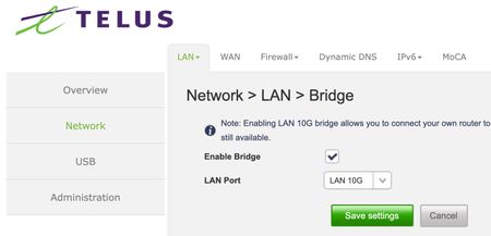

How to connect Unify Cloud Gateway Fibre to Telus NH20A via bridge mode.
I want to use the Unify Cloud Gateway Fiber (UCG-Fiber) to service the internal LAN and the Unify Access Points. Telus Network Access Hub (NH20A) Bridge mode 10G port --> Unify Cloud Gateway 10G WAN...
- 8 months ago
A couple of things to double-check:
- Ensure the WAN on your Unify Cloud Gateway is set to DHCP, not PPPoE, when connected through the NH20A in Bridge Mode.
- Make sure the bridge is enabled specifically on the 10G port of the NH20A (only that port will pass the WAN IP directly).
- Confirm that the Unify Cloud Gateway is not still caching your previous PPPoE config. A reboot after switching to DHCP usually helps.
