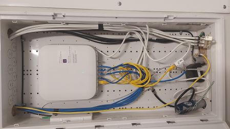

Our house has pre-wired ethernet cables and outlet/ports in the wall (Figure 4). Only 3 of them work, and I'm trying to get one of the others working. Two of the working ones is in the same outlet pl...
- 2 years ago
Who put the Ethernet plugs on the end of the blue wires? I'm guessing NOT the Telus tech.
I expect the wiring pattern does not match (there is an A pattern and a B pattern), or is wired for phone, not ethernet. I expect the tech simply made sure the jack at both ends of the cable he/she used were pattern matched to get it working.The white jack shown in your photo is a phone jack, not ethernet. What wire is connected to it, as often CAT5 is used for phone lines?
You might want to look up A/B wiring patterns, and make sure both ends of each CAT5 cable are wired the same.
Also, the ports on the NAH won't light unless there is a device connected to the other end that can respond to the router signals.

LordswornLance Google internet A and B color order. Open up your wall outlets and check them. Might be wrong redo the connections. If all the rj45s are correct at router then likely wall the outlet wrong.
