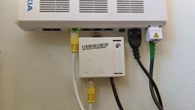

Eero Pro router with Nokia ONT
Hello,
I've recently been advised in this forum that I could use a 3rd-party modem instead of the T3200. (The reason for the change is a rather complicated setup that still relies on an old copper line between the ONT and Actiontec). Here is the thread: https://forum.telus.com/t5/Internet-Home-Phone/Got-Fibre-how-to-replace-Actiontec-modem-that-is-still-connected/td-p/108862
I've just received the Eero Pro but seem unable to connect it to the ONT. It simply does not recognize internet. Does this mean that I have to use the Actiontec in bridge-mode (which was exactly what I was trying to avoid), or is there a way to configure the Eero for data input directly from the ONT?
Thanks so much for your help!
Sam

    What happens when you connect the new router to the ONT with Ethernet cable?
    • SamSamSam's avatar
      SamSamSam
      Organizer
      Thanks for your reply!

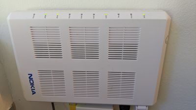

      The Eero installation app (which connects to router via phone/bluetooth) says no internet detected and to restart the modem. I restarted the ONT, but keep getting same result.  
      Here are a couple of photos of my peculiar setup in case it helps: at current, the data cable is routed outside again to hook up to the old copper line (which enters the house in another place and that I'm trying to "cut out" by installing the new router directly at ONT and do away with T3200).
