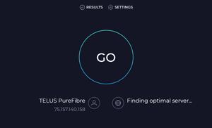

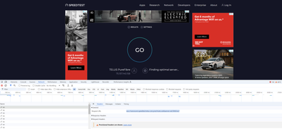

Router model is NH20T. DNS are 75.153.171.67,75.153.171.116 which is got from upstream device via dhcp. DNS should be OK since it can resolve correct IP address. I just figure out it isn't related with IP address. It does be related with the port. It looks like only outgoing 443 and 80 ports are allowed. i.e. following 2 wss URL aren't use default 443 port and can't access. It is very unreasonable that Telus block my outgoing ports and only allow 443 and 80. For incoming traffic, only 443 and 80 opened is OK. Will report telus support for the issue.
wss://ws_server19.nadgames.com:8443/BlueBox/websocket
wss://vancouver.speedtest.telus.com.prod.hosts.ooklaserver.net:8080/ws?

speedtest website will use websocket connection to fetch something. And some game server will use websocket also. Websocket is very popular protocol on internet. websocket can host on 443 port also. If it hosts on port 443, it works for me. But if it hosts on ports except 80,433, it won't work. I can't connect a ssh server(port 22) on public IP either. I do not have any route between my device and NH20T. My device connects with Telus WiFi 6 boost and boost connects with NH20T directly.
