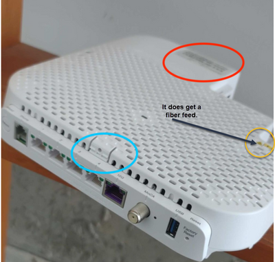

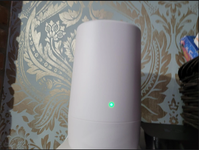

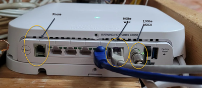

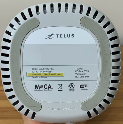

Nighthawk says this top unit is the NH20A, I was thinking the middle unit was the NH20A. The last (bottom unit) could be the B20, WiFi Booster? The middle unit is a ONT (fiber fed)/Router/WiFi Hub, made for Telus. If the top unit is the Arcadyan NH20A, and the bottom unit is the Booster (B20), what is the middle unit? Its Arcadyan, I know that much.
https://www.ifixit.com/Teardown/TELUS+Wi-Fi+Hub+(Arcadyan)+Teardown/129682
  • Upper device is the NH20A, a Fibre modem. It acts as an ONT and router, but has no Wi-Fi or POTS connection. It requires the third device for Wi-Fi, which gives you Wi-Fi 6.
    The middle device is the previous generation router/Wi-Fi device. Although it is usually connected to an ONT,  it also can be used with a direct Fibre connection through a SFP device.

      So the wall mounted NH20A has fiber in (ONT) and has, what looks like a 10Gbe WAN connection, and 4x Gbe LAN connection and a 2.5Gbe capable MOCA? It is a router, and we can connect any personally owned routers, switches or APs to said Telus ONT/Router, and distribute our own internal network as we wish? We can connect our 2.5/10Gbe capable equipment to said Telus ONT 10Gbe WAN connection, and take advantage of the max 2.5Gbs service Telus provides?
      PS: the picture of the NH20A does seems to have a phone jack (POT). Is it nonfictional?

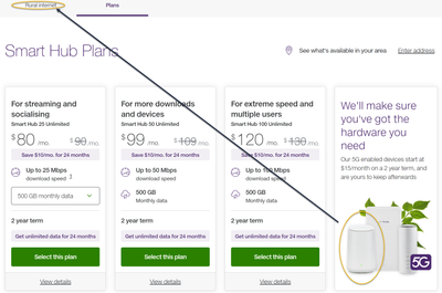

      "The middle device is the previous generation router/Wi-Fi device." Ah, so it's a previous device. Got it. Why don't they keep using the previous device, it seems/looks as or more capable than the wall mounted NH20A, with WiFi 6 included? I see a picture of this device in the Telus Rural 5G service provisions section (see above pic). Maybe it's not WiFi 6.
  • This is probably where this device (middle picture) came from. Rural Telus Customer Equipment/5G...etc plans.
    Though it is a Fiber fed ONT/Router/WiFi device, not a 5G cellular modem.
