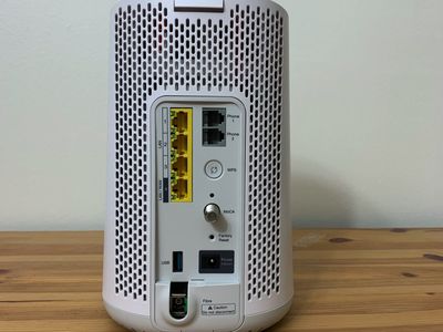

      One complete LAN/Wi-Fi network sharing the same ISP WAN on 1.5G service and future proofed for 2.5G service. Using two 2.5Gps WLAN fed routers. Now that I presently own one AX11000 router, which only has one 2.5Gps WLAN port and 8x 1Gps LAN ports and is Wi-Fi 6. Get the new Telus Arcadyan NH20A hub. Are any of the I/O on the NH20A 2.5G?
      • Nighthawk's avatar
        Nighthawk
        Last I heard Telus doesn't use the NH20A on connections of 1Gbps or less. If by some miracle they allowed you to have it, that device would have everything connectd to the NH20A sharing a physical network. Some posts indicate that device currently can't bridge a port. Anything connected to your router would still be a separate network unless it has the ability to act as a wifi access point or an extender. I didn't see anything in the settings for the AX11000 that specifically spelled out that ability. You're over-complicating your network setup.
