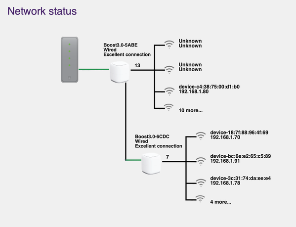

  • Update: Got it sort of working — but not how I planned.
    Turns out if you plug the second Boost 7 directly into the first one’s 2.5 Gb hub port, it auto-configures itself and joins the network. Both now show “wired – excellent connection.”
    That said, it’s a janky workaround. I wanted a third Boost to be wired into my switch (star layout), but there’s no way to manually configure or manage them. The Telus Connect app doesn’t show the Boost 7s at all, and the router’s web UI has zero mesh controls.
