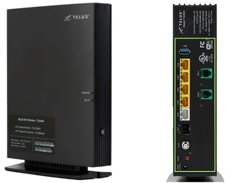

Thank you! I couldn't understand why my current setup with T3200M didn't work in the way I thought it should. Sadly, Telus wants to charge me $350 for the NH20A and "trashcan".
I'm trying to set up home automation + NAS + HomeLab in my apartment. It was pre-wired with fibre to the box in the closet, and the last Telus tech put the T3200M in the living room via the Ethernet wall jack connected to the closet wiring box. It seems like my best option is to put my router/firewall box in the closet with a managed switch, then hook up all the Ethernet jacks in the place. Am I headed the right direction?
- TheLastElite2 years agoOrganizer
Yes, that would be the best-wired connection to your devices, but your Wi-Fi range will suffer. You need your Wi-Fi router in a central location in your home, or you would need to use boosters.
