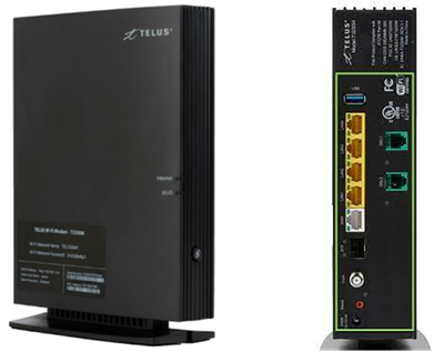

Currently the majority of the 1.0 Gbps installations utilize the Actiontec T3200M a GPON fibre connection. (Gigabit Passive Optical Network). For the average users this is a very well supported connection and installation type. Historically you should see a greater than 920 Mbps data transfer rate both up and down connection utilizing gigabit network cards and switches throughout your setup. TELUS claims the maximum throughput of 940Mbps symmetrically up, and down.

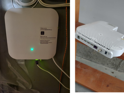

There are as well aa number of installations that utilize what has been referred to as the Trashcan router supplied by TELUS. I will not discuss that device as I have little experience with it. However, like the T3200M, the 1Gbps connection is fully supported on this device.
The 1.5 Gbps is as well supported on these devices. However, not in way you may think.
As the T3200M LAN ports (Yellow) support 1.0 Gbps connections, the fastest single connection to your hardware will be limited to that 1.0 Gbps connection. However, the trick, and key to TELUS’s thinking is that if you have multiple devices connected to your network, then, the aggregate downloads can achieve up to the advertised 1.5 Gbps download speeds utilizing these devices.

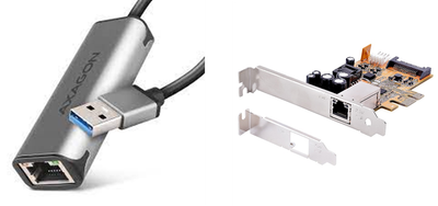

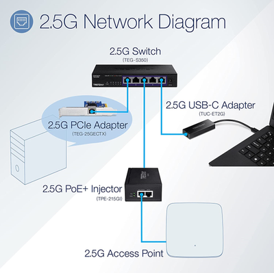

Hi,
The Telus 10G port supports 2.5GbE connection speeds. To set this up, you’ll need a TP-Link 2.5GbE switch, which you can easily daisy-chain from. If you’re using a laptop, a UGREEN 2.5GbE USB network adapter will do the trick. For a desktop PC, a TP-Link 2.5GbE PCIe card is a great option. Both solutions are around $30 each on Amazon, while a 5-port 2.5GbE switch runs about $69. I recommend sticking with TP-Link — their units have good heat dissipation, unlike the no-name brands, which tend to be unreliable.

That’s what I was doing previously but I couldn’t find anything about higher speed deployments that come with the NAH instead of that little white AIO device from that Reddit post. The installation in that post is was what was just removed from my home today. It came with a gigabit SFP that I was using, and still have. Deployments above 1g are not using the same standard or core equipment from the road to my apartment from what I can dig up. I know the installer replaced something at the road. I only have a gigabit sfp to copper and it doesn’t support sfp+ so I can’t test it yet. It seems like my end goal is pretty atypical (at least as of today) so info is sparse on what exactly has been done by the installer. When I used the gigabit sfp into my media converter (configuration I used for multiple years until this change) the router refuses to grab DHCP info from TELUS which makes me think it may not allow a device that is not registered in the system. The thing I’m not sure of is if it’s the SFP module or the NAH that needs to be involved in obtaining the lease, I’m suspecting the NAH may be necessary. I figure I’ll just send and see what happens, the worst case is I need to feed my WAN from the 10g rj45 and convert that to SFP+ for the dream machine.

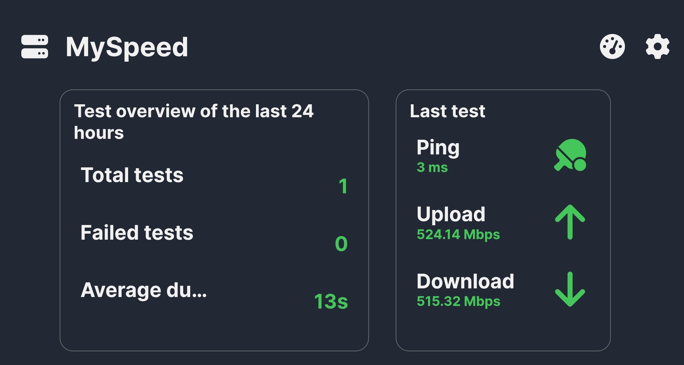

My most recent speed test, have the 500M/500M plan.
Don't have a whole bunch of downloads happening during a speedtest. I am watching a YouTube video during test.
